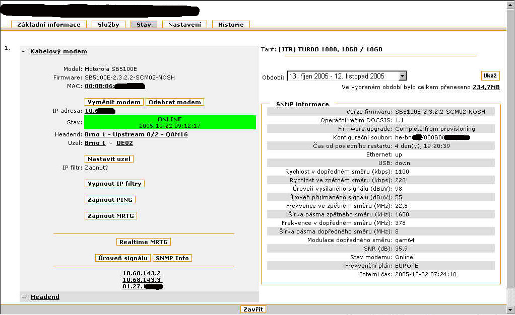

tomus Odesláno 18. září 2012 Sdílet Odesláno 18. září 2012 Ukazu ti jak vypada takovy dekodovany konfiguracni soubor, ktery si modem stahuje z TFTP serveru, je sice starsiho data a pro modem Motorola SB5100E, ale predpokladam, ze pro ty Cisca to bude stejne. Nastavovat se tam da hlavne rychlost (MaxRateDown), pocet IP adres (MaxCPE), blokovani portu (Integer 135), adresa a soubor pro stahovani updatu FW , ale nic moc dalsiho. Takze myslim ze muzes byt v klidu- Main { NetworkAccess 1; MaxCPE 4; ClassOfService { ClassID 5; MaxRateDown 1100000; MaxRateUp 220000; PrivacyEnable 0; } SwUpgradeServer 81.27.192.30; SwUpgradeFilename "SB5100E-2.3.2.2-SCM02-NOSH-NNEMN.p7"; MfgCVCData 0x3082037d30820265a00302010202104d4e272dad34bede0ca18e487c7f82ca300d06092a864886f70d0101050500306f310b3009060355040613024245311f301d060355040a131674436f6d4c616273202d204575726f2d444f4353495331153013060355040b130c4361626c65204d6f64656d73312830260603550403131f4575726f2d444f43534953204361626c65204d6f64656d20526f6f74204341301e170d3031303932353030303030305a170d3133303932343233353935395a306a310b3009060355040613025553311d301b060355040a13144d6f746f726f6c6120436f72706f726174696f6e31143012060355040b130b4575726f2d444f; MfgCVCData 0x43534953312630240603550403131d436f646520566572696669636174696f6e20436572746966696361746530820122300d06092a864886f70d01010105000382010f003082010a0282010100c4e3084c7703230c7dea78816a1a5a24075d9bd34031908e9912f3e02f51ba8307acbf2f2719c9dc2ae5ff7922097fb4f1b87d181048d9822758712cad923039b1bca26e4eac678611499b2c9c0e6d157b45070f82c974543418128ee6ad1194a7f1cfb69568ba4618e1c1c28419b3cad2239918988519c1b2ead4d1c37024045d69bf19ce0724c6bc9d77480608bc594bf8b5749d06bc3202b6bedc1b9a9a79575e2e3791f1a8e35910419ce25dd433e419; MfgCVCData 0x4b6af635610e39d25ac72e362e220fbb230f19774e574dc36ec9cf08823a15877699ee69b41b323f543fcab3929b94fe87aebee2c163327d193ed3247034d6065150cd8c1b1ca9e7b8c6dc7a1c410203010001a31a301830160603551d250101ff040c300a06082b06010505070303300d06092a864886f70d010105050003820101004a027b532916b045ffa051158bda0ce53fa6837808c7ddd2b42385666c37a2e1f05c6936ec497a295d76565bea07ada2a6064a8263bf53c3f4a8ff2838e503cc2bc0eb0e748322b6625237d2ccc9a7b7be0eb850e6dd4bc95dcd8bca6fa4fa5d54e53470c0e40b4a175cee3adf31f02c17d01c35af781e2ab61310e2; MfgCVCData 0x6e6f070bf50b7e86baedf9b818e0c30cd95f4a55d585717670921ba87067a07efea6dda7022794cb84f79d8d67fa8204f9067067ff48191177056af3c3fc4f86684887deac8bffd89c6de79e390065c90af89170d970c15af7782ed5ca60be86912c8f4a2666c91f68b9113f76f83f7bbb605216ce5cb410e0e9f380337f97d42a5924c8; SnmpMibObject iso.3.6.1.2.1.69.1.6.4.1.2.1 Integer 4 ; SnmpMibObject iso.3.6.1.2.1.69.1.6.4.1.3.1 Integer 1 ; SnmpMibObject iso.3.6.1.2.1.69.1.6.4.1.4.1 Integer 0 ; SnmpMibObject iso.3.6.1.2.1.69.1.6.4.1.5.1 Integer 3 ; SnmpMibObject iso.3.6.1.2.1.69.1.6.4.1.6.1 Integer 2 ; SnmpMibObject iso.3.6.1.2.1.69.1.6.4.1.7.1 IPAddress 0.0.0.0 ; SnmpMibObject iso.3.6.1.2.1.69.1.6.4.1.8.1 IPAddress 0.0.0.0 ; SnmpMibObject iso.3.6.1.2.1.69.1.6.4.1.9.1 IPAddress 0.0.0.0 ; SnmpMibObject iso.3.6.1.2.1.69.1.6.4.1.10.1 IPAddress 0.0.0.0 ; SnmpMibObject iso.3.6.1.2.1.69.1.6.4.1.11.1 Integer 6 ; SnmpMibObject iso.3.6.1.2.1.69.1.6.4.1.12.1 Integer 0 ; SnmpMibObject iso.3.6.1.2.1.69.1.6.4.1.13.1 Integer 65535 ; SnmpMibObject iso.3.6.1.2.1.69.1.6.4.1.14.1 Integer 135 ; SnmpMibObject iso.3.6.1.2.1.69.1.6.4.1.15.1 Integer 139 ; SnmpMibObject iso.3.6.1.2.1.69.1.6.4.1.2.2 Integer 4 ; SnmpMibObject iso.3.6.1.2.1.69.1.6.4.1.3.2 Integer 1 ; SnmpMibObject iso.3.6.1.2.1.69.1.6.4.1.4.2 Integer 0 ; SnmpMibObject iso.3.6.1.2.1.69.1.6.4.1.5.2 Integer 3 ; SnmpMibObject iso.3.6.1.2.1.69.1.6.4.1.6.2 Integer 2 ; SnmpMibObject iso.3.6.1.2.1.69.1.6.4.1.7.2 IPAddress 0.0.0.0 ; SnmpMibObject iso.3.6.1.2.1.69.1.6.4.1.8.2 IPAddress 0.0.0.0 ; SnmpMibObject iso.3.6.1.2.1.69.1.6.4.1.9.2 IPAddress 0.0.0.0 ; SnmpMibObject iso.3.6.1.2.1.69.1.6.4.1.10.2 IPAddress 0.0.0.0 ; SnmpMibObject iso.3.6.1.2.1.69.1.6.4.1.11.2 Integer 17 ; SnmpMibObject iso.3.6.1.2.1.69.1.6.4.1.12.2 Integer 0 ; SnmpMibObject iso.3.6.1.2.1.69.1.6.4.1.13.2 Integer 65535 ; SnmpMibObject iso.3.6.1.2.1.69.1.6.4.1.14.2 Integer 135 ; SnmpMibObject iso.3.6.1.2.1.69.1.6.4.1.15.2 Integer 139 ; SnmpMibObject iso.3.6.1.2.1.69.1.6.4.1.2.3 Integer 4 ; SnmpMibObject iso.3.6.1.2.1.69.1.6.4.1.3.3 Integer 1 ; SnmpMibObject iso.3.6.1.2.1.69.1.6.4.1.4.3 Integer 0 ; SnmpMibObject iso.3.6.1.2.1.69.1.6.4.1.5.3 Integer 3 ; SnmpMibObject iso.3.6.1.2.1.69.1.6.4.1.6.3 Integer 2 ; SnmpMibObject iso.3.6.1.2.1.69.1.6.4.1.7.3 IPAddress 0.0.0.0 ; SnmpMibObject iso.3.6.1.2.1.69.1.6.4.1.8.3 IPAddress 0.0.0.0 ; SnmpMibObject iso.3.6.1.2.1.69.1.6.4.1.9.3 IPAddress 0.0.0.0 ; SnmpMibObject iso.3.6.1.2.1.69.1.6.4.1.10.3 IPAddress 0.0.0.0 ; SnmpMibObject iso.3.6.1.2.1.69.1.6.4.1.11.3 Integer 6 ; SnmpMibObject iso.3.6.1.2.1.69.1.6.4.1.12.3 Integer 0 ; SnmpMibObject iso.3.6.1.2.1.69.1.6.4.1.13.3 Integer 65535 ; SnmpMibObject iso.3.6.1.2.1.69.1.6.4.1.14.3 Integer 445 ; SnmpMibObject iso.3.6.1.2.1.69.1.6.4.1.15.3 Integer 445 ; SnmpMibObject iso.3.6.1.2.1.69.1.6.4.1.2.4 Integer 4 ; SnmpMibObject iso.3.6.1.2.1.69.1.6.4.1.3.4 Integer 1 ; SnmpMibObject iso.3.6.1.2.1.69.1.6.4.1.4.4 Integer 0 ; SnmpMibObject iso.3.6.1.2.1.69.1.6.4.1.5.4 Integer 3 ; SnmpMibObject iso.3.6.1.2.1.69.1.6.4.1.6.4 Integer 2 ; SnmpMibObject iso.3.6.1.2.1.69.1.6.4.1.7.4 IPAddress 0.0.0.0 ; SnmpMibObject iso.3.6.1.2.1.69.1.6.4.1.8.4 IPAddress 0.0.0.0 ; SnmpMibObject iso.3.6.1.2.1.69.1.6.4.1.9.4 IPAddress 0.0.0.0 ; SnmpMibObject iso.3.6.1.2.1.69.1.6.4.1.10.4 IPAddress 0.0.0.0 ; SnmpMibObject iso.3.6.1.2.1.69.1.6.4.1.11.4 Integer 17 ; SnmpMibObject iso.3.6.1.2.1.69.1.6.4.1.12.4 Integer 0 ; SnmpMibObject iso.3.6.1.2.1.69.1.6.4.1.13.4 Integer 65535 ; SnmpMibObject iso.3.6.1.2.1.69.1.6.4.1.14.4 Integer 445 ; SnmpMibObject iso.3.6.1.2.1.69.1.6.4.1.15.4 Integer 445 ; SnmpMibObject iso.3.6.1.2.1.69.1.6.4.1.2.5 Integer 4 ; SnmpMibObject iso.3.6.1.2.1.69.1.6.4.1.3.5 Integer 1 ; SnmpMibObject iso.3.6.1.2.1.69.1.6.4.1.4.5 Integer 0 ; SnmpMibObject iso.3.6.1.2.1.69.1.6.4.1.5.5 Integer 3 ; SnmpMibObject iso.3.6.1.2.1.69.1.6.4.1.6.5 Integer 2 ; SnmpMibObject iso.3.6.1.2.1.69.1.6.4.1.7.5 IPAddress 0.0.0.0 ; SnmpMibObject iso.3.6.1.2.1.69.1.6.4.1.8.5 IPAddress 0.0.0.0 ; SnmpMibObject iso.3.6.1.2.1.69.1.6.4.1.9.5 IPAddress 0.0.0.0 ; SnmpMibObject iso.3.6.1.2.1.69.1.6.4.1.10.5 IPAddress 0.0.0.0 ; SnmpMibObject iso.3.6.1.2.1.69.1.6.4.1.11.5 Integer 6 ; SnmpMibObject iso.3.6.1.2.1.69.1.6.4.1.12.5 Integer 0 ; SnmpMibObject iso.3.6.1.2.1.69.1.6.4.1.13.5 Integer 65535 ; SnmpMibObject iso.3.6.1.2.1.69.1.6.4.1.14.5 Integer 593 ; SnmpMibObject iso.3.6.1.2.1.69.1.6.4.1.15.5 Integer 593 ; SnmpMibObject iso.3.6.1.2.1.69.1.6.4.1.2.6 Integer 4 ; SnmpMibObject iso.3.6.1.2.1.69.1.6.4.1.3.6 Integer 1 ; SnmpMibObject iso.3.6.1.2.1.69.1.6.4.1.4.6 Integer 0 ; SnmpMibObject iso.3.6.1.2.1.69.1.6.4.1.5.6 Integer 3 ; SnmpMibObject iso.3.6.1.2.1.69.1.6.4.1.6.6 Integer 2 ; SnmpMibObject iso.3.6.1.2.1.69.1.6.4.1.7.6 IPAddress 0.0.0.0 ; SnmpMibObject iso.3.6.1.2.1.69.1.6.4.1.8.6 IPAddress 0.0.0.0 ; SnmpMibObject iso.3.6.1.2.1.69.1.6.4.1.9.6 IPAddress 0.0.0.0 ; SnmpMibObject iso.3.6.1.2.1.69.1.6.4.1.10.6 IPAddress 0.0.0.0 ; SnmpMibObject iso.3.6.1.2.1.69.1.6.4.1.11.6 Integer 17 ; SnmpMibObject iso.3.6.1.2.1.69.1.6.4.1.12.6 Integer 0 ; SnmpMibObject iso.3.6.1.2.1.69.1.6.4.1.13.6 Integer 65535 ; SnmpMibObject iso.3.6.1.2.1.69.1.6.4.1.14.6 Integer 593 ; SnmpMibObject iso.3.6.1.2.1.69.1.6.4.1.15.6 Integer 593 ; SnmpMibObject iso.3.6.1.2.1.69.1.6.4.1.2.7 Integer 4 ; SnmpMibObject iso.3.6.1.2.1.69.1.6.4.1.3.7 Integer 1 ; SnmpMibObject iso.3.6.1.2.1.69.1.6.4.1.4.7 Integer 2 ; SnmpMibObject iso.3.6.1.2.1.69.1.6.4.1.5.7 Integer 1 ; SnmpMibObject iso.3.6.1.2.1.69.1.6.4.1.6.7 Integer 2 ; SnmpMibObject iso.3.6.1.2.1.69.1.6.4.1.7.7 IPAddress 0.0.0.0 ; SnmpMibObject iso.3.6.1.2.1.69.1.6.4.1.8.7 IPAddress 0.0.0.0 ; SnmpMibObject iso.3.6.1.2.1.69.1.6.4.1.9.7 IPAddress 0.0.0.0 ; SnmpMibObject iso.3.6.1.2.1.69.1.6.4.1.10.7 IPAddress 0.0.0.0 ; SnmpMibObject iso.3.6.1.2.1.69.1.6.4.1.11.7 Integer 6 ; SnmpMibObject iso.3.6.1.2.1.69.1.6.4.1.12.7 Integer 0 ; SnmpMibObject iso.3.6.1.2.1.69.1.6.4.1.13.7 Integer 65535 ; SnmpMibObject iso.3.6.1.2.1.69.1.6.4.1.14.7 Integer 3128 ; SnmpMibObject iso.3.6.1.2.1.69.1.6.4.1.15.7 Integer 3128 ; SnmpMibObject iso.3.6.1.2.1.69.1.6.4.1.2.8 Integer 4 ; SnmpMibObject iso.3.6.1.2.1.69.1.6.4.1.3.8 Integer 1 ; SnmpMibObject iso.3.6.1.2.1.69.1.6.4.1.4.8 Integer 2 ; SnmpMibObject iso.3.6.1.2.1.69.1.6.4.1.5.8 Integer 1 ; SnmpMibObject iso.3.6.1.2.1.69.1.6.4.1.6.8 Integer 2 ; SnmpMibObject iso.3.6.1.2.1.69.1.6.4.1.7.8 IPAddress 0.0.0.0 ; SnmpMibObject iso.3.6.1.2.1.69.1.6.4.1.8.8 IPAddress 0.0.0.0 ; SnmpMibObject iso.3.6.1.2.1.69.1.6.4.1.9.8 IPAddress 0.0.0.0 ; SnmpMibObject iso.3.6.1.2.1.69.1.6.4.1.10.8 IPAddress 0.0.0.0 ; SnmpMibObject iso.3.6.1.2.1.69.1.6.4.1.11.8 Integer 6 ; SnmpMibObject iso.3.6.1.2.1.69.1.6.4.1.12.8 Integer 0 ; SnmpMibObject iso.3.6.1.2.1.69.1.6.4.1.13.8 Integer 65535 ; SnmpMibObject iso.3.6.1.2.1.69.1.6.4.1.14.8 Integer 8080 ; SnmpMibObject iso.3.6.1.2.1.69.1.6.4.1.15.8 Integer 8080 ; SnmpMibObject iso.3.6.1.2.1.69.1.6.4.1.2.9 Integer 4 ; SnmpMibObject iso.3.6.1.2.1.69.1.6.4.1.3.9 Integer 1 ; SnmpMibObject iso.3.6.1.2.1.69.1.6.4.1.4.9 Integer 2 ; SnmpMibObject iso.3.6.1.2.1.69.1.6.4.1.5.9 Integer 2 ; SnmpMibObject iso.3.6.1.2.1.69.1.6.4.1.6.9 Integer 2 ; SnmpMibObject iso.3.6.1.2.1.69.1.6.4.1.7.9 IPAddress 0.0.0.0 ; SnmpMibObject iso.3.6.1.2.1.69.1.6.4.1.8.9 IPAddress 0.0.0.0 ; SnmpMibObject iso.3.6.1.2.1.69.1.6.4.1.9.9 IPAddress 0.0.0.0 ; SnmpMibObject iso.3.6.1.2.1.69.1.6.4.1.10.9 IPAddress 0.0.0.0 ; SnmpMibObject iso.3.6.1.2.1.69.1.6.4.1.11.9 Integer 17 ; SnmpMibObject iso.3.6.1.2.1.69.1.6.4.1.12.9 Integer 67 ; SnmpMibObject iso.3.6.1.2.1.69.1.6.4.1.13.9 Integer 67 ; SnmpMibObject iso.3.6.1.2.1.69.1.6.4.1.14.9 Integer 0 ; SnmpMibObject iso.3.6.1.2.1.69.1.6.4.1.15.9 Integer 65535 ; SnmpMibObject iso.3.6.1.2.1.69.1.7.1.0 Integer 1 ; SnmpMibObject iso.3.6.1.2.1.69.1.7.2.0 Integer 4 ; SnmpMibObject iso.3.6.1.2.1.69.1.7.3.1.3.10.68.0.74 Integer 4 ; SnmpMibObject iso.3.6.1.2.1.69.1.7.3.1.3.10.68.0.75 Integer 4 ; SnmpMibObject iso.3.6.1.2.1.69.1.7.3.1.3.10.68.130.6 Integer 4 ; SnmpMibObject iso.3.6.1.2.1.69.1.7.3.1.3.10.68.130.7 Integer 4 ; SnmpMibObject iso.3.6.1.2.1.69.1.2.1.7.1 Integer 4 ; SnmpMibObject iso.3.6.1.2.1.69.1.2.1.2.1 IPAddress 81.27.192.51 ; SnmpMibObject iso.3.6.1.2.1.69.1.2.1.3.1 IPAddress 255.255.255.255 ; SnmpMibObject iso.3.6.1.2.1.69.1.2.1.6.1 String "@" ; SnmpMibObject iso.3.6.1.2.1.69.1.2.1.7.2 Integer 4 ; SnmpMibObject iso.3.6.1.2.1.69.1.2.1.2.2 IPAddress 81.27.192.51 ; SnmpMibObject iso.3.6.1.2.1.69.1.2.1.3.2 IPAddress 255.255.255.255 ; SnmpMibObject iso.3.6.1.2.1.69.1.2.1.4.2 String "private" ; SnmpMibObject iso.3.6.1.2.1.69.1.2.1.5.2 Integer 3 ; SnmpMibObject iso.3.6.1.2.1.69.1.2.1.6.2 String "@" ; /* CmMic 012613736a0bdb8edba925f302c3dc19; */ /* CmtsMic 65b8fa7b17e2e0041432c6e9b8fb87ba; */ /*EndOfDataMkr*/ /* Pad */ } Dalsi vec je pak dohled na dalku, to se dela pomoci systemu IMS, ktery ziskava data z modemu pomoci protokolu SNMP, vypada to nejak takto: Citovat Kabel 150 Mb/s - Komfort Compal VF, VTV box, CA modul Brno Odkaz ke komentáři https://www.techforum.cz/topic/3525-co-v%C5%A1echno-m%C5%AF%C5%BEe-upc-d%C4%9Blat-s-modemem-na-d%C3%A1lku/#findComment-57664 Sdílet na ostatní stránky More sharing options...
