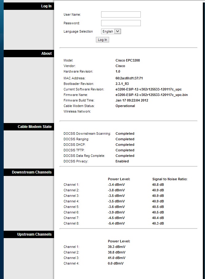

192.168.100.1
Power level values ​​are OK
Signal to noise ratio is excellent
The problem is elsewhere, I'm not an expert...
